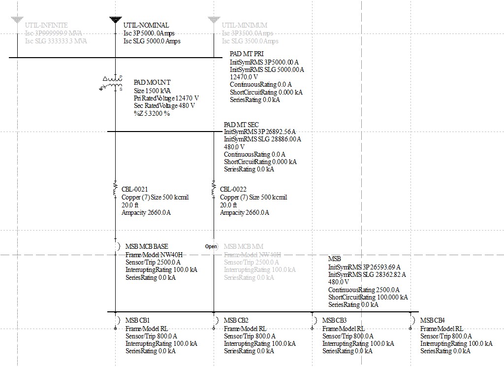

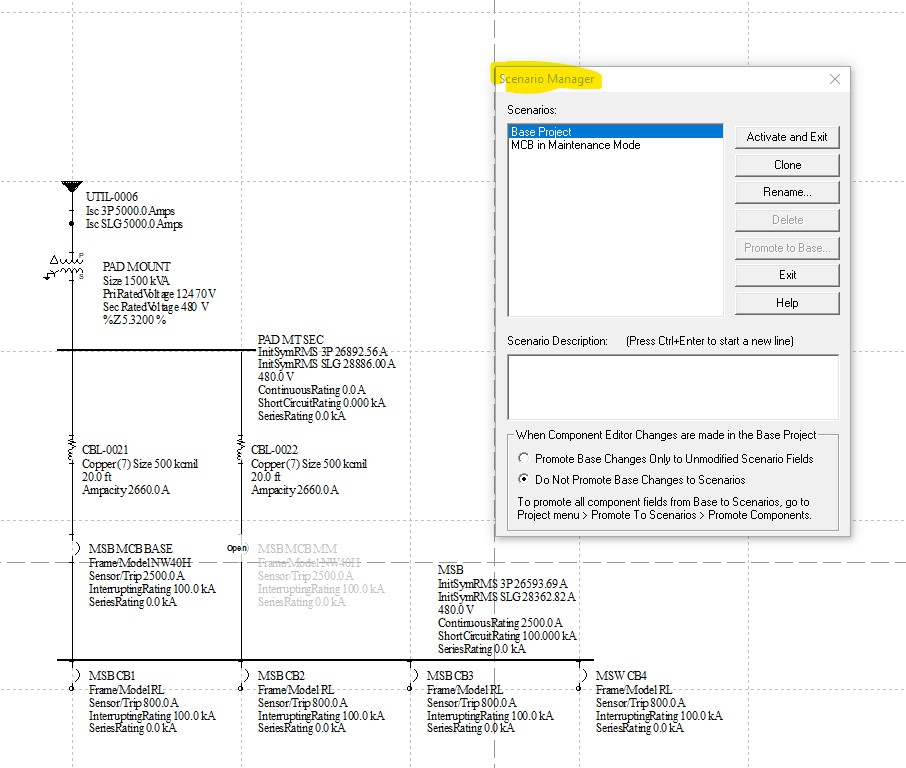

Unless I'm misunderstanding I don't know why you couldn't model two main breakers in parallel, one with the normal settings and one with the maintenance mode settings and put the MM breaker out of service in the base scenario and the normal settings out of service in the MM scenario. No scenario would have both main breakers in service at the same time.
 Post subject: Re: Arc energy reduction mode labeling
PostPosted: Thu Jun 22, 2023 12:54 pm
Example. Base MCB is normal operating condition. MM MCB is maintenance mode operating condition.

Incidentally, some engineers use this same methodology to analyze the available fault current from the utility. You can do it this way or change in each scenario in the Scenario Manager or a combination both. I like doing it this way sometimes (depending on what I'm analyzing) so I can see the effect of one vs. the other very quickly without having to leave the base model and go to each scenario.
For example: Infinite bus, Nominal from Utility and Minimum from Utility with Nominal in service and the other two "off":
