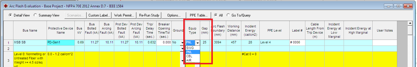

Attached are some pictures of an arc flash that occurred in a 480/277V panel, I'm trying to determine what can be done in the future to prevent this.
An employee attempted to reset one of the parking lot light circuit breakers when he heard shorting/arcing from within the panel. The breaker being reset was located on right side of the panel, about 2/3 of the way down (I believe it was located where the copper is missing on the right busbar). The bulk of the damage occurred on the left side of the panel where it destroyed the load side terminals of almost all of the breakers. Based image of the panel cover charring, the bulk of the damage was done on the left side, however there appears to be quite a bit of damage behind the busbars inside of the box. Eventually the main building feeder ground fault activated (set points 1200A, 18 cycles) ending the fireworks. Thankfully the employee walked away unharmed.
Additional info:
-Available fault current was in the 6-8kA range
-Upstream fuses had incorrectly been replaced with Bussman FRS-400 (should have been 225A)
-Circuit breaker that was being reset had a short somewhere along its run
-The single pole breakers have arc shoots above the tab where where they bolt onto the panel
-Several of the 1-pole/20A breakers have been used for daily switching of overhead lights (rated SWD)
-Panel is ~16 years old
-The breaker that was being reset appears to have little/no damage
My best guess is that trying to reset the breaker into a short created an arc inside which vented out, propagating into an arc flash. Is it possible that the daily switching of the lighting circuit breakers deposited a layer of conductive carbon over time which contributed to the arc flash? Would adding wall 277V toggle switches or adding a lighting contractor panel be a good solution? Is there any sort of preventative maintenance that would have helped? Any information would be greatly appreciated.
[ATTACH]315[/ATTACH]
Arc Flash Calculation to IEEE 1584-2002.xlsx [15.05 KiB]
Downloaded 400 times
[ATTACH]318[/ATTACH]
