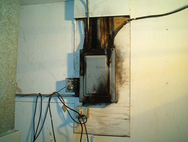

at work we have a ab drive line up with about 5 PF 700 drives. They pull around 1500-2400 amps total. these drives have 480 feeding a breaker then thru a NRU that converts it to DC and that feeds the buss for the drives then back to ac that feeds the motors and they have a 5000 cal rating, they said it could not be any lower. they allow operators to turn the disconnects on /off on these drives with just cat 0 PPE, Is this safe or should there be some type of remote operation on the drive disconnects located outside of the AF boundary of 20 ft? What would be the correct way according to 70 E?

One line
Here is the one line

The arcing fault current less than 10kA makes it pretty clear that the fault is just clearing in a long long time. Are the trip settings in the upstream breaker loaded correctly in the software? Are you aware that you can apply a manual cutoff time (minimum 2s)?
Can the breaker settings be adjusted to something faster for the projected arcing current range while still maintaining coordination with downstream devices? if not, can the breaker be replaced with another breaker with more trip curve adjustment options or with fuses (as long as coordination is still achieved)?
5000 cal/cm2 can definitely be reduced in your case by orders of magnitude, even if for some reason (say, coordination) you have to get light and overcurrent sensors (e.g. ABB REA systems) that send a trip signal to the upstream breaker.
