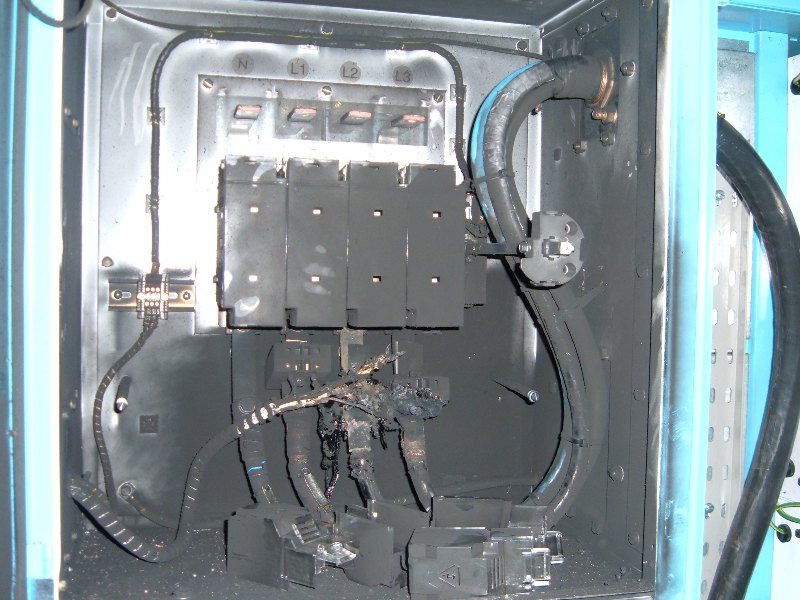

PostPosted: Mon Dec 14, 2009 10:02 am
CEDEng wrote:
Thanks again, that's all great info.
I do indeed already include all the (previously NEC required) label information (voltage, current...).
The question really arose for two reasons:
a) I've noticed the arc flash label on the competition's machines;
b) The customer asked me to put it on.
I'm thinking "a" is a direct result of "b," but that's really not important. What matters to me is that I do the right thing, and I believe I am, and you have all reinforced my conclusion.
Thanks again!
You should just put a simple label that meets the NEC 110.16 requirements, like this one.
