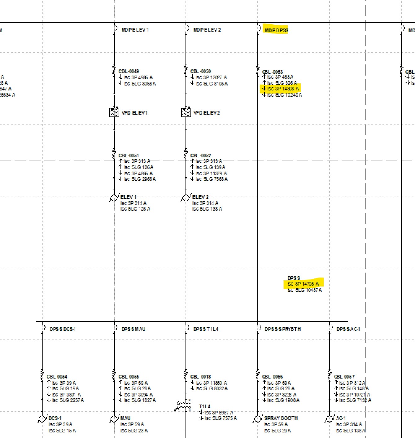

Does the bus in question have motor loads that are contributing to the fault current at that bus? Not having the benefit of seeing your one-line so speculating here but it could be motor contribution from one direction and utility contribution from the other direction creating higher fault current at the bus than at the protective device.

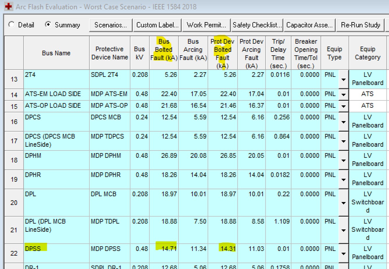

Here are some screen shots illustrating this for bolted fault current. I don't have a datablock that shows arcing fault current with current direction and am too lazy to make one at the moment but I think it illustrates the point.

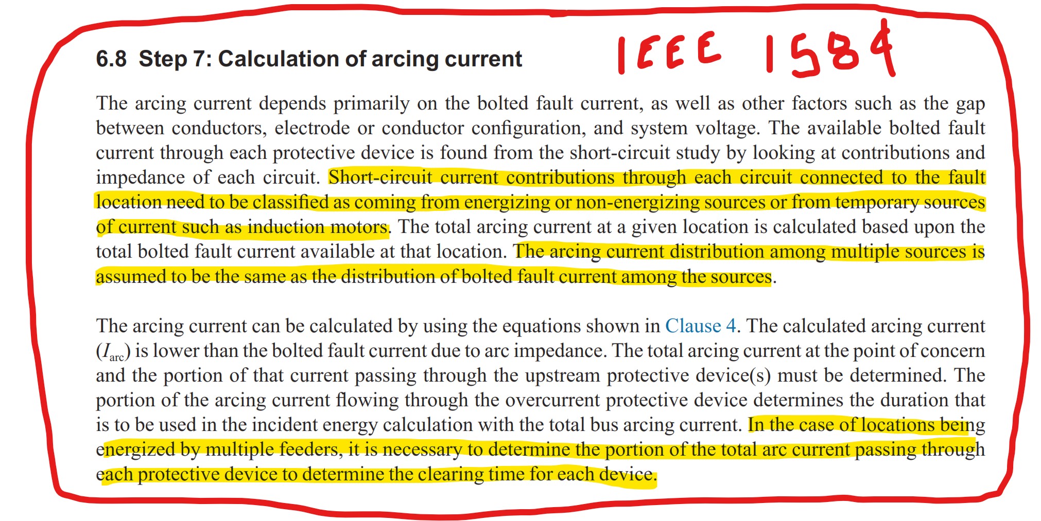

Also, from IEEE 1584-2018:
