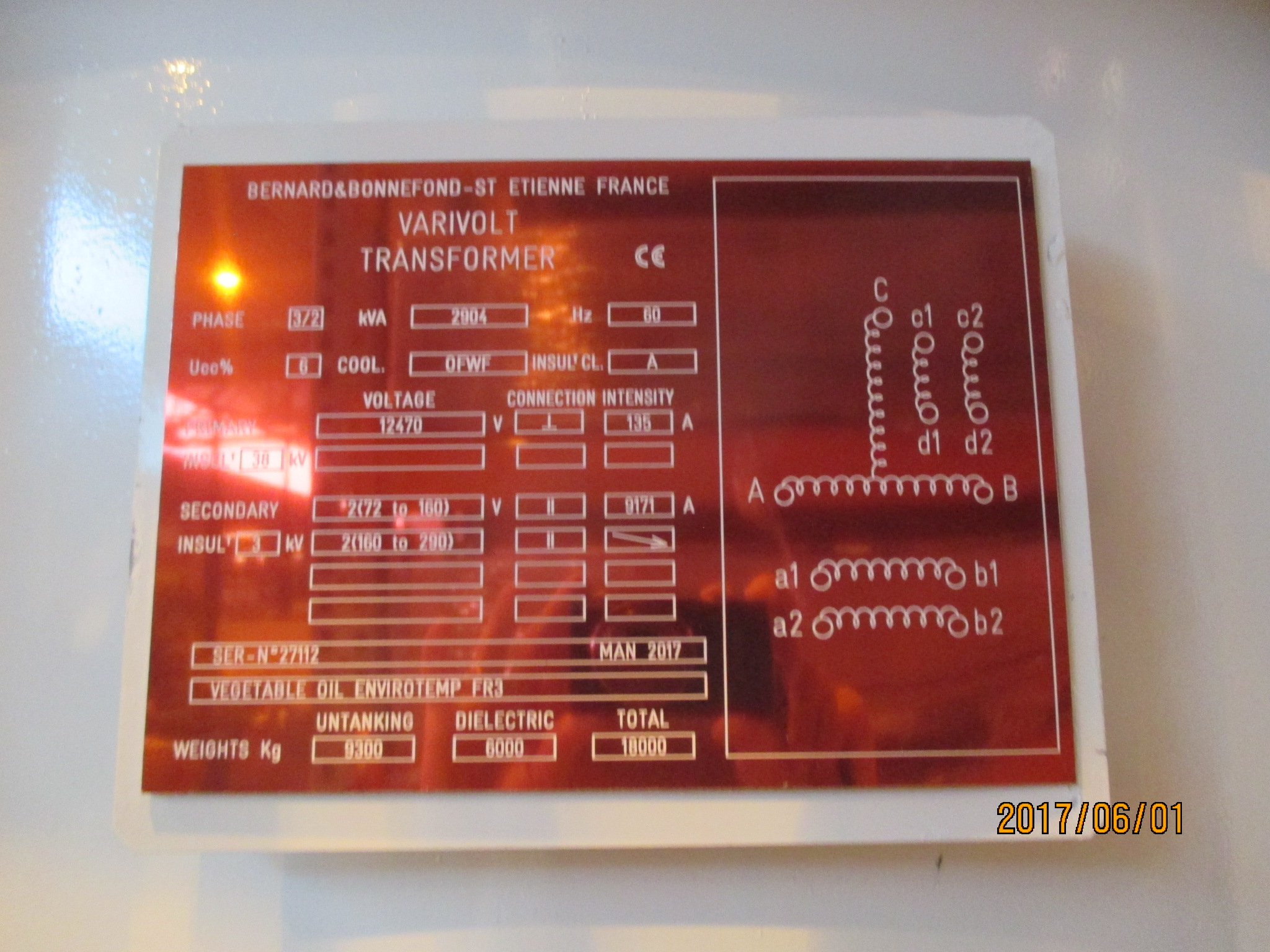

Does anyone have suggestions for arc-flash hazard labeling of equipment on the secondary side of a Scott connected transformer? The transformer is a "Varivolt" design and the secondary windings deliver a voltage between 72 and 290V. My understanding is that the IEEE 1584 equations apply to three phase systems. SKM does not model Scott connected transformers. Any ideas?

Scott T-Connected transformer, 3 phase primary, 2 phase secondary. The transformer has a rotating winding with sliding contacts that act as a tap changer.
The IEEE 1584 standard does not apply to 2-phase systems.
It doesn't apply to single phase either but testing by Mersen and others has shown that single phase arcs aren't that much different from three phase arcs in terms of energy. So applying a 3 phase model would produce a higher result but not that much higher.
