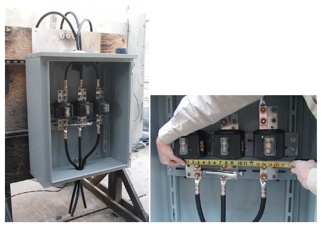

I did some research on fuse clearing and found the following information:
