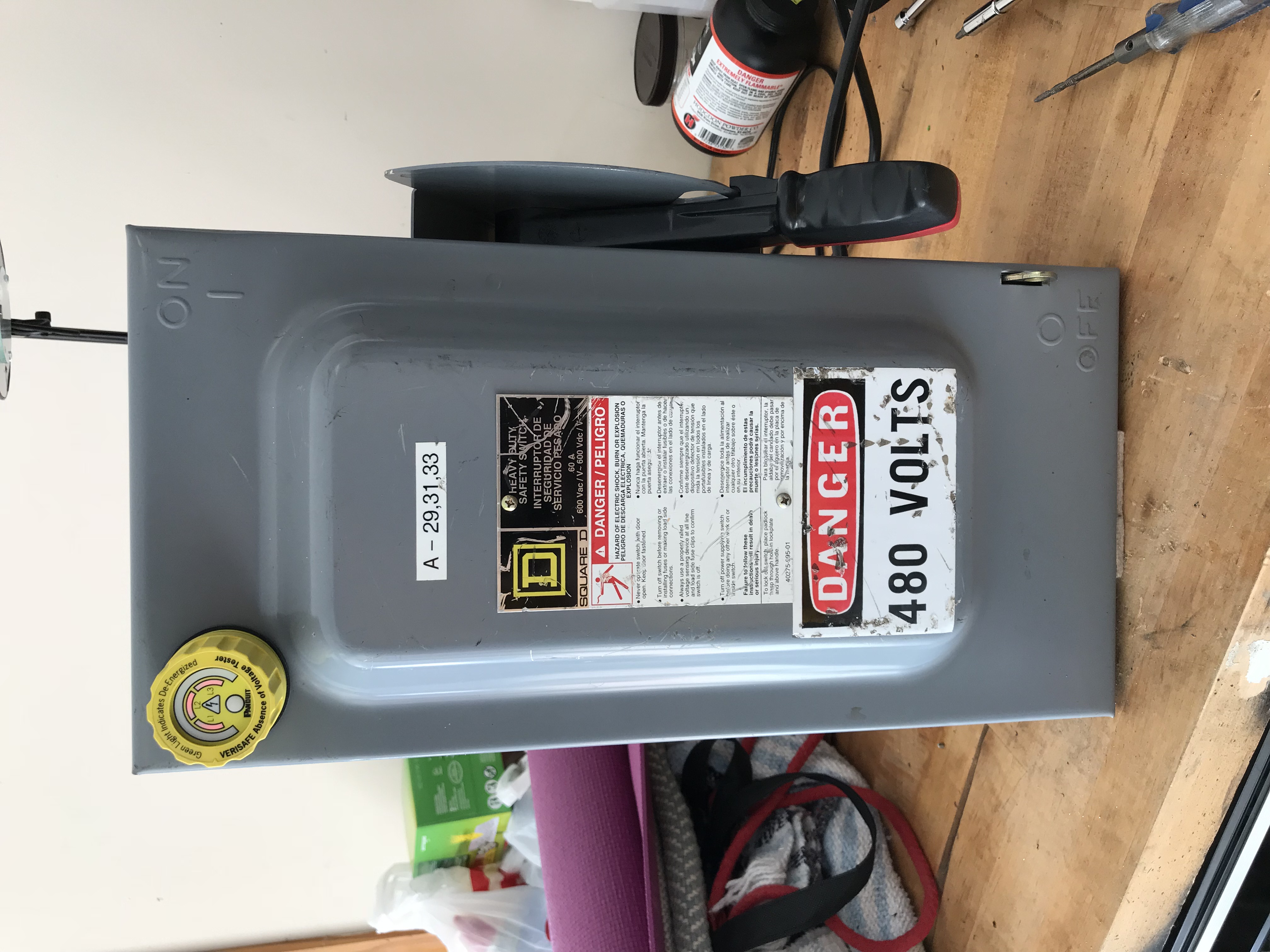

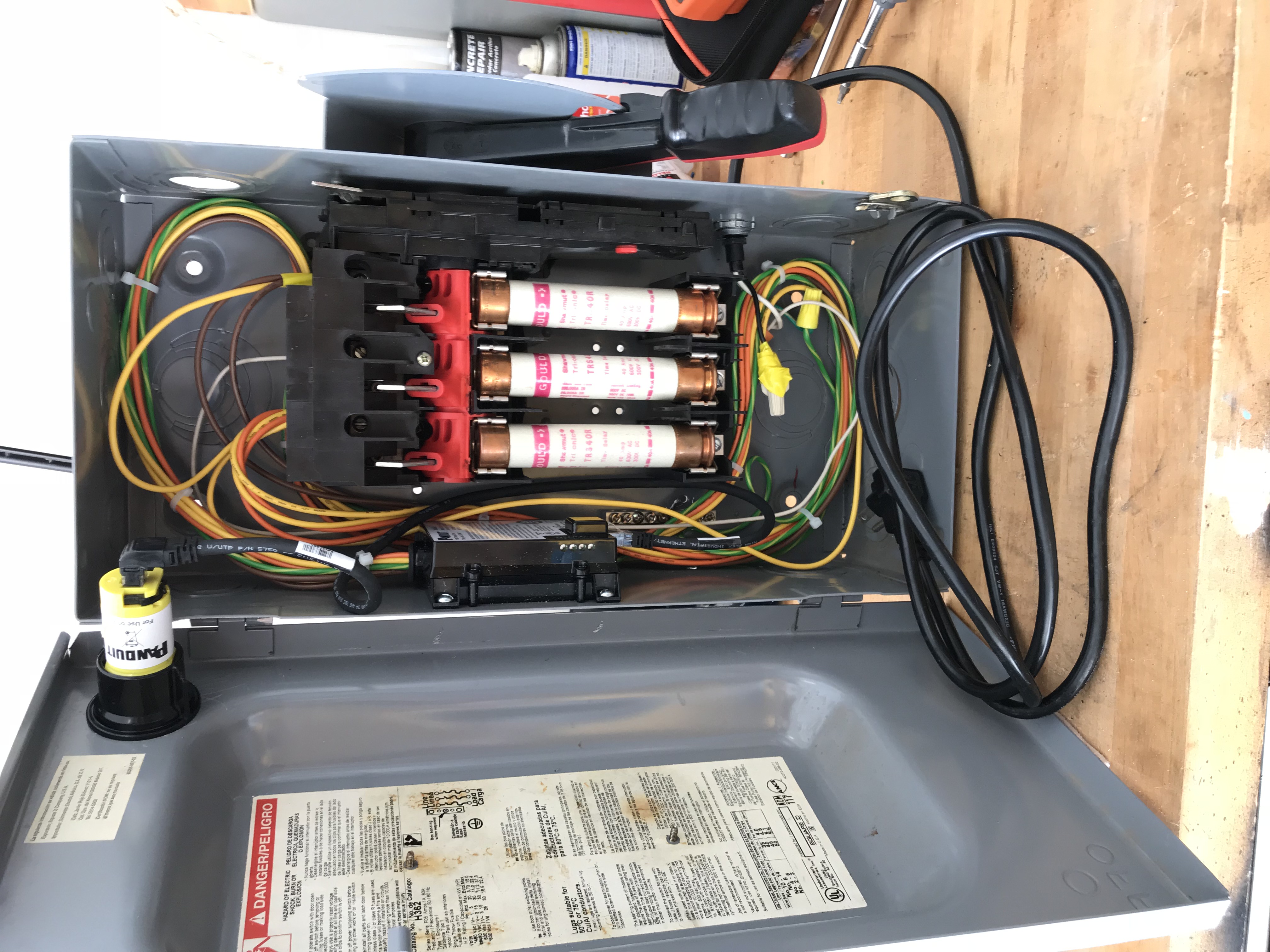

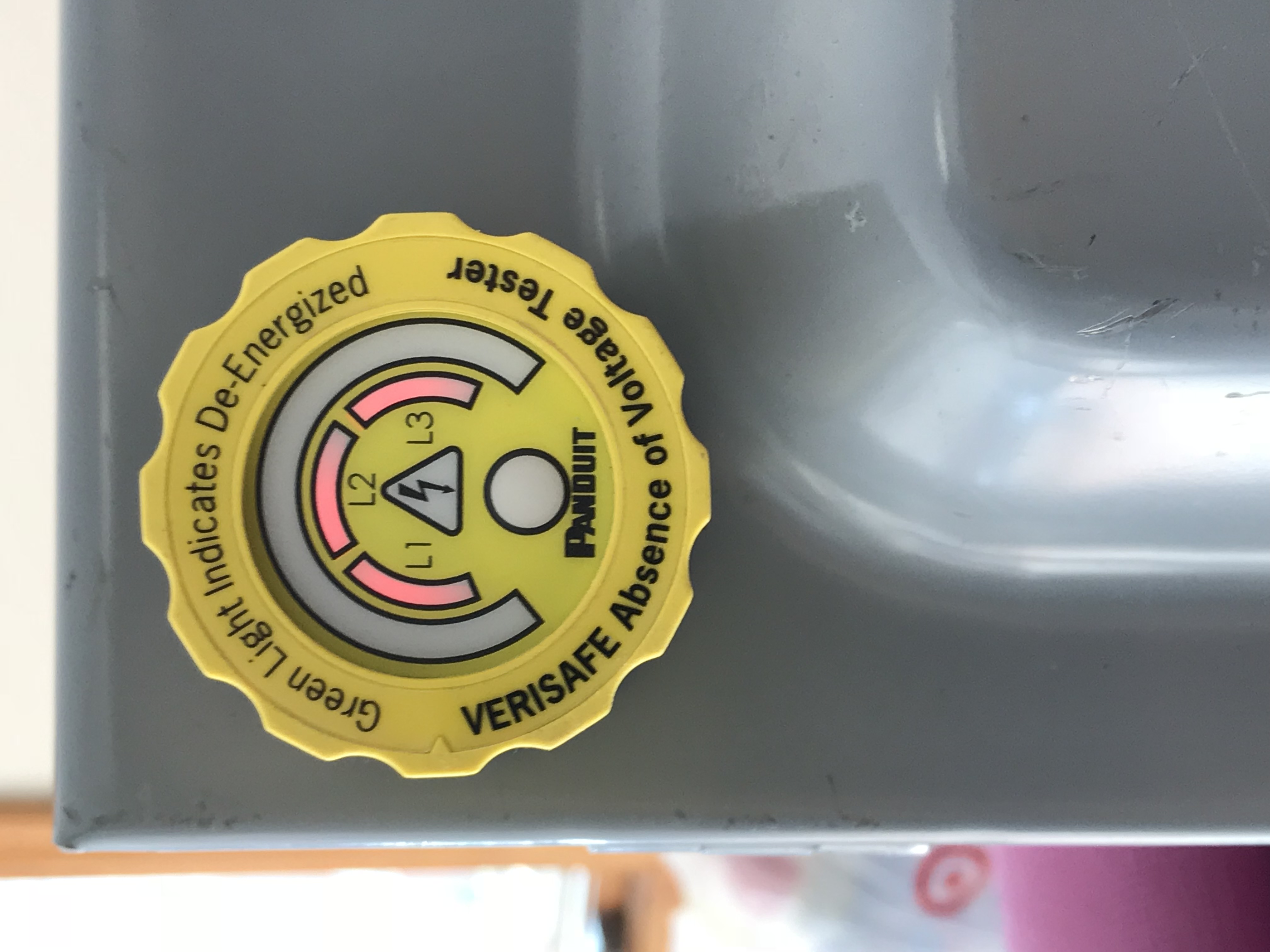

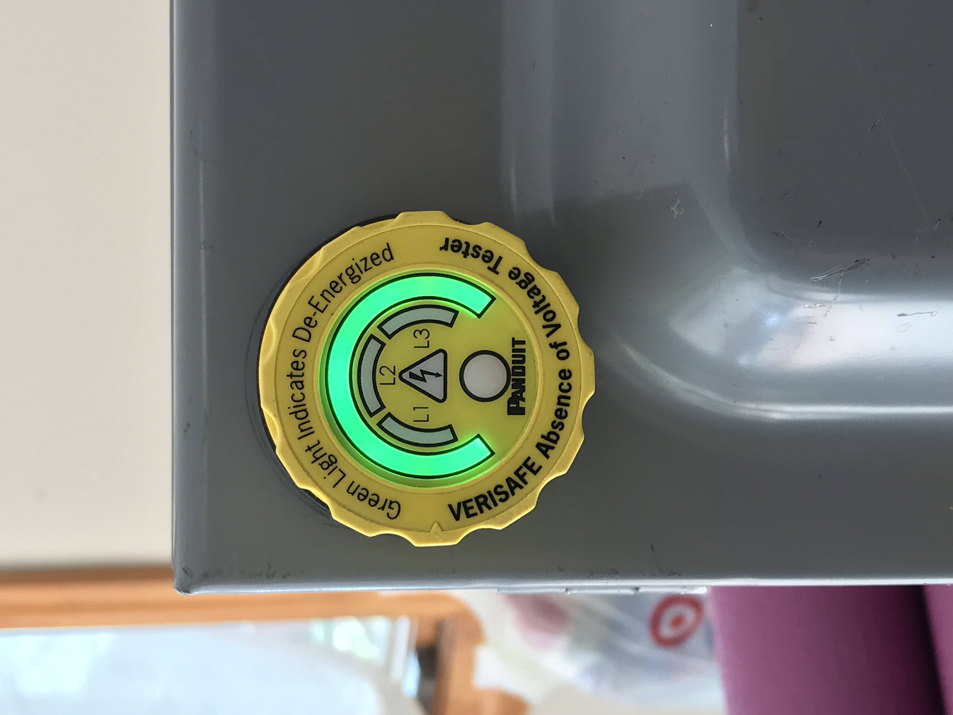

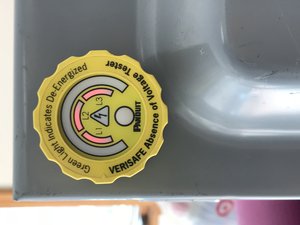

Panduit has been making an Absence of Voltage Tester for several years. They call it VeriSafeâ„¢ Absence of Voltage Tester. This device has voltage presence lights built in showing when voltage is present. When the equipment is deenergized, it is not enough to just see the lights have gone out. After pressing the test button, the AVT will go through the steps required to test for the absence of voltage. This AVT uses a battery to check itself before and after testing for the absence of voltage; thus complying with (4). I teach a lot of NFPA 70E / Arc Flash seminars and I have installed this into a safety switch to show how it operated. As long as I see the three red lights before denergizing the equipment and then see the green light after denergizing the equipment, I would trust this device.

Charles R. Miller wrote:
As long as I see the three red lights before deenergizing the equipment and then see the green light after deenergizing the equipment, I would trust this device.
I agree.
But what do the green lights show if it is miswired, say all three voltages supplied by the A-phase only or one phase not wired at all.
It someone is familiar with the installation instructions, they could quickly look to see where all eight conductors are terminated after the enclosure door is opened. If I saw all six phase conductors terminated in one spot on one phase, I would have serious concerns about the rest of the wiring in that facility.

Guest wrote:
...after the enclosure door is opened.
Opening the door should not be a requirement in order to verify the detector is displaying correctly when I was not involved in its installation.

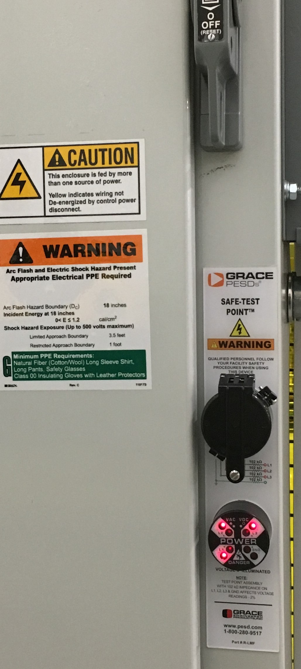

We recently installed this one for review by our corporate safety engineers.
It has both indicator lights and test points.
