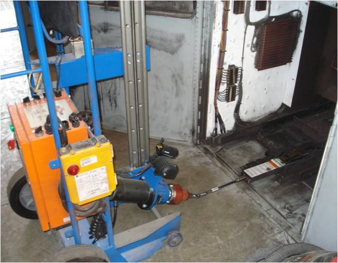

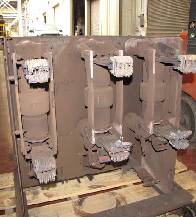

It is also refered to as First trip. The main issue here is that an arc flash study relies on accuarte opening times, traditional breaker testing requires the breaker to be opened and removed from the switchgear, then tested via primary injection, the problem with this method is that if the breaker has not been operated in a long time the dried grease can delay the opening time, after the breaker has been cycled the times typically are shorter. When the breaker gets opened to be revomed for testing, the real opening time data is lost.
A special transducer is magnetically coupled to the front of the breaker. After the technician moves from the exposure zone, the breaker is operated. The transducer sends valuable vibration signals that represent breaker first trip timing and mechanical condition to a handheld analyzer. This unique breaker vibration signature is compared to a database library of known signatures.
Post test analysis can include superimposing the test breaker signature upon good breaker signatures, to quickly spot potential problems. Should the breaker fail the first trip test in the field, it is necessary to perform complete shop reconditioning or remanufacturing in order to return the breaker to a condition that will ensure proper operation and validate the arc-flash study. Frequent performance of the breaker vibration signature test ensures performance and exercises the breaker mechanism.
