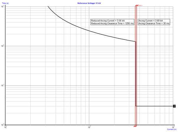

Correct me if I'm wrong but doesn't IEEE Std 1584 cater for this by taking the higher of the two incident energy values calculated (first from the arcing current [Iarc] and then a reduced arcing current [Iarc_min])?
Section 4.5 of 1584-2018 states the following...
Calculate a second set of arc duration, using the reduced arcing current to determine if the arcing current variation has an effect on the operating time of protective devices and consequently incident energy.
See the attached image which illustrates a big difference in arc durations for arcing current and reduced arcing current.
In our studies this often happens, we always recalculate the incident energy with the Iarc_min, we prefer to do it in that way, we think is a safer practice for the user

IEEE 1584 stipulates running the calculations for two arcing current levels and using the worst case results. It provides equations for both currents (Iarc and Iarc_min). SKM does this by default when the IEEE 1584 method is selected. Alternatively, SKM also allows a user-defined table to be used for the 2nd arcing current values.
