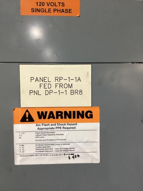

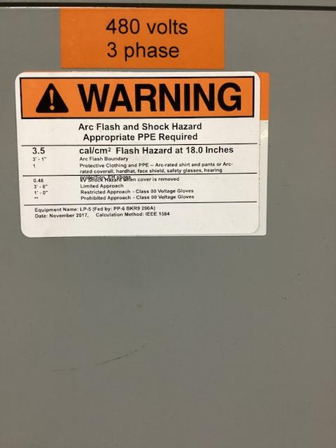

Question:
How would you handle this?
Thanks in advance..
Phil

[ Are you referring to the AC voltage 130(C)(15)(a) and the DC voltage 130.(C)(15)(b)?

Pretty much what Mike said.
To use the table method you need to know and understand what fault current and clearing time means.
Where are you located? There are probably some members on here that can give you a proposal on performing a study and labeling.

I'm in Georgia. The tables you are referencing are the ones I cited above?
