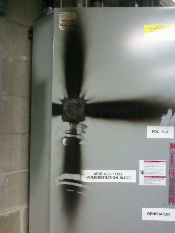

PostPosted: Mon Oct 12, 2009 1:44 pm
Closed door, 13.8kV switch, only HRC 2 per the tables with doors closed.
I can do this all day, I see this stuff everyday. I don;t care who intreprets what how, or if a FPN is enforceable or not, unless it is arc rated, switchgear can not be relied on to contain an arc flash.
