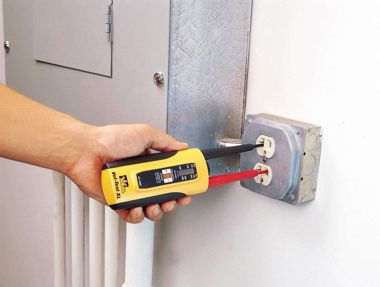

Could someone please point out to me where the 2018 70E has verbiage that prohibits the voltage testing of receptacles without insulated gloves on. The attached picture is just for clarity of the question. 130.7.C.7 says that protection needs to be worn where there is the danger of hand injury from an electrical shock from exposed energized parts. I would contend that there is nothing exposed when testing a duplex with a modern voltage tester. I would also argue that the Restricted Approach Boundary for shock protection is not being crossed since no conductive parts are exposed. Thanks in advance for any help.

The receptacle is safe, unless there is obvious damage.
The only reason a person might wear gloves is if they sometimes touch the metal probes of a test meter. As odd as that sounds, people often forget and touch the tips of the meter probe.

As mentioned above, no exposed energized parts. As stated in 70E and CSA Z462 the restricted approach boundary is avoid contact. Even if the receptacle was somehow damaged, I likely would not wear rubber insulated gloves.

I believe plugging in a device is more dangerous with the prongs being energized by your fingers before it is fully inserted in the outlet. (North American, some regions have safer plugs)

I am in total agreement with what you have stated about "avoid contact", however, isn't this area of 70E somewhat problematic?? My reference is not to a 120V receptacle, however, what about a control panel with dozens of exposed/energized 120V terminals inside the panel and on the door, the "avoid contact" clause seems like a prelude to trouble.

I know it might seem like "above and beyond" but doing the same thing all the time provides better results. Teach the qualified electrical work to use shock protection gloves if they expect or could have voltage present. Yes, in an outlet, it is touch safe to not able to be exposed. But that is a rare time they would use the meter for troubleshooting items that are touch safe.
