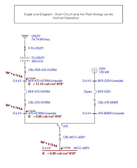

I am trying to recreate a study that was done previously. Fairly basic system. There are two operation modes, normal and on emergency generator. I have attached my file and the study. I am able to come close to normal operation results in the report. However, the emergency operation results are quite different. I have tried many things to make it work to no avail.

Yes. I've tried to compare it and put it in exactly same data (same breaker, same generator data) as what was there in the old report into the newer ETAP version. I've come close to normal operation (within 5-10%).
Emergency operation using the generator is different. I get the same Ibf. Incident energy is different.
I tried doing many different things..but when I force FCT to 2 sec max...I get quite close.
Is there any reason as to why the original report would have this "forced"?

I think I figured it out.
I believe the FCT was forced because this was the bus or point between the Generator and the Generator breaker (no PD - labelled BKR-GEN lineside on the SLD).
I don't know if this bus should even be faulted. But this is what the consultant did.
And the '2 second rule' was because of:
A 2 second maximum arc flash duration is a reasonable cut off based on IEEE 1584-2002. It's the average time for a person to react to arc flash and leave the harzard area. So it's meaningless to calculate the energy after 2 sec.
Is this generally acceptable?
