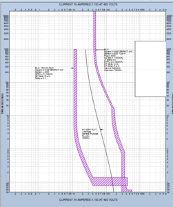

We recently had a main on an MDP trip because we had arcing in a piece of equipment. The main is a 4kA breaker set at 3600 LTD. There is a 1000A breaker (of which i don't know the specs) and a 1200A fuse between the piece of equipment and the main. I have attached the TCC for the fuse and breaker and as far as I understand coordination they should be good. Can anyone help explain how this could have happened?

Some of your terminology is not clear but if I understand correctly you have a circuit breaker (Masterpact) with a fuse and another circuit breaker on the load side, and the question is how/why the circuit breaker can trip before the fuse and wondering why you had a case of an apparent loss of coordination.
What are your estimated fault currents, both for short circuit and for arcing. At least if you knew these (and recognizing they are estimates) tells us if we're working in the instantaneous or the long term trip range.
The first and most obvious consideration once we've gotten past this point is that the fuse is shown as only a single line while the circuit breaker which is clearly an electro-mechanical one or at the very least a very early electronic trip unit is shown with a trip range. This is opposite most TCC's which nearly always show fuses with a range and circuit breakers as lines. So they might actually be too close together and you might have miscoordination just because the fuse setting is too close to the circuit breaker.
Second when is the last time that the circuit breaker was actually serviced and tested? Although the typical concern for circuit breakers is that they trip too slowly, this is not always what happens. Older thermal trip units and dash pots in particular and pretty much anything relying on a calibrated spring has a tendency to trip either way too slowly or way too quickly. You definitely cannot assume especially with older equipment that malfunctions always result in tripping too slowly. In my experience it tends to be roughly 25% of them go the other way and trip way too quickly, even falling below the long term trip setting. The software only predicts performance of a properly functioning breaker, not one that has some age on it and doesn't perform to specification. Considering that you're talking about a 4,000 A frame circuit breaker, I'm thinking that probably the incident energy rating is so high that everyone is scared to even get close to it in today's environment and as a result they've been letting it just sit there rusting away.
Finally you may need to dig into the details of the circuit breaker trip unit itself. So far the data is only for phase-to-phase faults while arcing faults typically start out at least as phase-to-ground faults. If the circuit breaker has ground fault detection, phase imbalance detection, negative sequence detection, or even under/over voltage detection it could easily trip without the fuse ever detecting a fault at all.

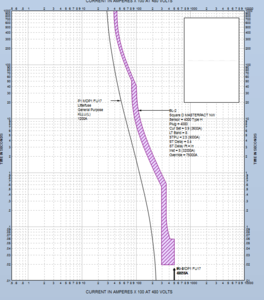

Thanks Paul! The available fault current is 25kA but I think you hit the nail on the head with the ground fault detector... Is there anything I can do about it?
Interesting. The majority of TCCs that I have seen/created always has a trip range for breaker and fuses. Some fuses do show as a single line but majority have a range. I also took a quick look at the curves in the IEEE Buff, Blue, and Red books and only saw TCCs with a time range for breakers.
 Post subject: Re: Coordination
PostPosted: Fri Apr 29, 2016 8:38 am
When fuses are shown as a range, the area is between the minimum melt (or damage) curve and the maximum clearing curve. Use the lower melt curve to coordinate with downstream devices, and the clearing time to coordinate with upstream devices. Presumably, the curve shown is the clearing curve.
When tightly coordinating a main with a feeder, it may be necessary to consider the loads on the un-faulted feeders. This will add to the current seen by the main, and have the effect of shifting the curve left.
Also, consider at the 5000 A shown, you are in the sub-cycle range on a curve that assumes symmetrical current. A bit of DC offset will cause the zero crossing (and therefore interruption) to be delayed.

I would still take the opportunity to test the circuit breaker first and foremost just to be sure. All breakers have a finite life in terms of how many heavy faults they are designed to withstand before they fail and if you haven't tested it, this is a good opportunity to do so.
As to what you can do about ground fault...a fuse is inherently a single phase device. Simply put, a fuse as such can't really trip on ground fault. Right now based on your description, you have precisely one protection zone for ground fault and that's everything tied to the 4,000 A frame circuit breaker. There is no coordination to worry about, right?
Now let's delve into why that pesky ground fault protection is there in the first place and why NEC requires it on any system above about 1,000 A or so (the exact requirement has changed from one edition to the next over time).
Let's say you have a dead short to ground on your system. Then if you said 25 kA is a dead short phase-to-phase, the ground fault is 14.4 kA. Working backward from here this means that the resistance through the grounding and bonding must be under 277 / 14,400 = 0.02 ohms. And even if we consider a high enough ground fault to trip the system on the long term trip setting of 1200 A (taking the fuse case), we need no more than 277 / 1200 = 0.23 ohms resistance through the grounding wiring. If your wiring met these requirements then it is possible that the phase overcurrent protection (the fuses as well as the circuit breaker) could provide adequate phase fault as well as ground fault protection. If you were down at the utilization level of your system with say a 15 A circuit breaker then these requirements are much more modest and more importantly, reasonable. That's why we don't require ground fault protection for low current circuits...the phase fault protection does double duty.
So if you follow NEC to the letter and do it as cheaply as possible, you'd put ground fault protection on the primary distribution breakers only that are say 1,000 A or larger and nothing on the rest of the system. Where does this leave us? We have huge protection zones and a single fault anywhere can be like trying to find a needle in a haystack, to say nothing of the problems it causes by tripping half the plant off.
The answer is that you really should calculate your potential ground fault current at pretty much every level. Somewhere around 100 A is the point where ground fault current will not trip the phase protection circuit any more and you need ground fault protection everywhere above this level. So obviously your fuses are simply not going to work and this is also true for the unknown/unnamed circuit breaker. Phase protection will not double as ground fault protection until we get down to the very smallest protective devices in the system.
Then we come to coordination of ground fault breakers. You need to coordinate ground fault circuits. In most cases ground fault circuits are very simple without all the complicated trip curves. Ground fault coordination is almost always based purely on time but then we come to the next issue.
With a solidly grounded system the ground fault current is very large and can cause a lot of damage. Thus interruption needs to happen as quickly as possible to avoid severe damage so coordination is simply not practical to do. I have never seen any attempts to coordinate solidly grounded systems on ground fault. The only "practical" alternative in a solidly grounded system is to use zone selective relaying. And I'm not saying it's not practical because it requires pulling two wires from every downstream circuit breaker back to the upstream circuit breaker and it requires an inhibit input function on the upstream circuit breaker so that zone selective relaying can work. Between installing the extra wiring and having the special feature in the circuit breakers, zone selective relaying is not realistic for a retrofit and often not practical even on new installations.

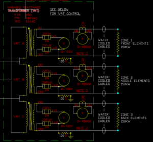

Your input on an isolation transformer as a possible solution made me realize the elements are heated by a Variable Reactance Transformer (VRT). The drawing doesn't show a ground on the secondary side (other than for the voltmeter). If there truly is no ground on the VRT is it possible to add one to accomplish the same thing? Does it currently not exist because it would cause problems?

The transformer is effective the same thing as 3 separate single phase transformers except that it is in a single housing. The front end is wired in delta but single the secondary coils are not wired together at all this makes it actually three single phase transformers in a wye-wye configuration. I recognize that the primary side is wired as delta but since the secondary side is not wired together at all, it simply saves some money to have a single lead to each pair of coils and since it would be an inexpensive design modification to a standard delta-wye transformer to order it with 6 secondary leads instead of purchasing three individual transformers. Note that right away this configuration not only passes zero sequence (ground fault) currents from secondary to primary but also it creates circulating currents within the transformer that cause excessive heating due to imbalances either between coils or between loads.
There are grounds clearly on the diagram just past the fuses and connected via a resistor. If you don't have these hooked up then you will have an ungrounded system. If this is the case on the first ground fault the system will continue to operate although if you measure your phase voltages to ground one of them will be at or near zero. On the second fault you will get a line-ground-line fault across the ground which due to the high impedance of the grounded circuit often won't trip the fuses and will cause a lot of damage.
If the grounds are hooked up then each of the 3 phase legs is individually terminated to ground via a 100 ohm resistor and the output voltage according to nameplate has a maximum of 52 V. So with 52 / 100 = 0.52 A, it's definitely a high resistance grounded system and pretty much operates as the above except that on the first ground fault a low current flows instead of no current at all. This results in zero sequence current (ground fault) being passed right through the transformer and onto the primary side which was your concern but there are additional problems.
At this point we have to consider the current on the secondary side and the size of the fuses. There are two clues. First it states "water cooled cables" on the diagram and second with three individual 150 kVA transformers (450 kVA / 3) with a 52 V nominal secondary voltage, we get about 2.9 kA as a maximum current. No doubt the fuses are vastly larger than the 0.5 A ground fault current that we would expect.
With such a configuration, ground faults will not be detected until the second ground fault forms on another phase, resulting in a phase-ground-phase fault. These are higher current than single phase-ground faults and not quite as high as 3 phase bolted faults but again, unlikely to cause a trip but will do a lot of damage while they persist before burning off enough equipment. This is inherent in the design. During this fault though again...it gets passed over to the primary (480 V) bus and this time has a high likelihood of being able to trip an upstream ground fault protection circuit.
In terms of correcting the problem, there are a couple ways around this. The first one would be to put a voltage meter across the 100 ohm resistor. Thus ground fault current can be directly read since I=V/R...the current is equal to the voltage divided by 100. The meter could also be replaced with a sensor/relay that directly triggers an alarm and/or trips on excessive current. Along the same lines shorting all 3 coils of the transformer together and connecting this connection through a single resistor simplifies the ground fault detection/tripping and has a secondary advantage that this makes the transformer a true delta-wye. The cabling will absorb the zero sequence currents within the transformer and no zero sequence currents will be passed to the primary side of the transformer.
The second method relies on another issue with this design. For the U.S. at least, NEC 250.20(B) requires the system to be grounded. 250.20(D) does not apply (voltage is too low), and it doesn't fall under any of the exceptions in 250.21(A) or 250.22. There is also not an exception anywhere in Article 427. If this applies to your system, then the simple solution is to short out the resistors altogether and remove them from the circuit, although this may also require increases in cable dimensions. At that point you will be better off jumpering one phase of each of the coils together to form a true wye-connected secondary. Thus your problems are solved except for the fact that a ground fault in the resistance heating elements is probably going to be more destructive than it has been in the past. You can still implement the ground fault relay described above except that in this case it would require a CT on the ground leg(s) of the transformer which would then be tied to a trip mechanism such as a circuit breaker. Article 427 recommends but does not require this for industrial facilities.
If you want to actually measure how much ground fault current you have at any point in the system, you can easily do this. First you need a flexible CT adapter for your multimeter. Here is an example from one vendor but pretty much all the major meter vendors carry these things:

To read zero sequence current at any point in your system, wrap the CT around all of the cables in question so for instance you can wrap it around all three 480 V phase leads coming from the power source. If there is a ground current, then I1+I2+I3 will NOT be equal to zero. This is also true in single phase circuits as well...just wrap it around the power and neutral wiring. This is incidentally the principle behind a ground fault circuit interrupter.
