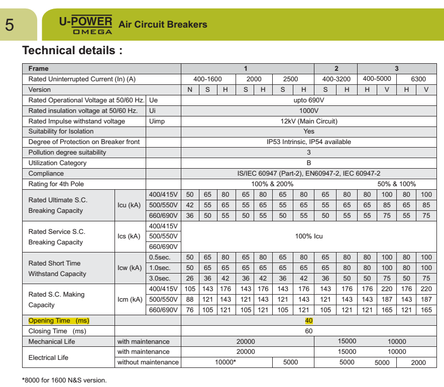

I agree with mdy and wouldn't call those errors as much as explanations of what the software is doing for the settings you have applied. For example the *N9 is for "Max Arcing Duration Reached" means the settings you have configured for your fault calculations are pre-maturely "extinguishing" the fault before it has run its complete duration. In this case you've probably set the Max Arching Duration to 2 seconds. We are allowed to use 2 seconds as a reasonable amount of time for a worker to remove themself from a hazardous situation (set as seen below).
N2 works similarly and if you look in the Report Options tab you'll see the "Cleared Fault Threshold" value you've set the program to run to.
