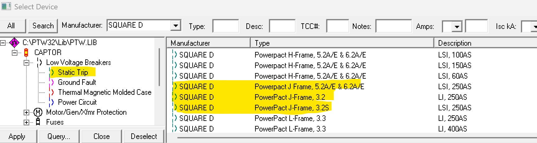

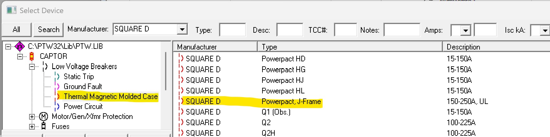

PostPosted: Tue Jun 02, 2026 3:44 am
Here is what I was trying to explain. Both are J-Frame PowerPact but in different folders as one is Electronic Trip and on is Thermal Mag. It is easy to be looking in the wrong place in SKM. Easy Power may or may not be similar. Just don't know:

 Post subject: Re: Adding devices to library in EasyPower
PostPosted: Fri Oct 02, 2026 7:55 am
Posts: 78
As it turns out, the EasyPower device libraries have separate entries for trip units that are independent from the breakers. This theoretically allows you to pair wildly incompatible trip units to breakers of different manufacturers, but the relevant part is that breakers are not categorized by what type of trip unit they're implementing...So classifying what trip unit is being used will not help an EasyPower user find their breaker any easier. Just a bit of information for its own sake, I guess.
