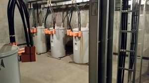

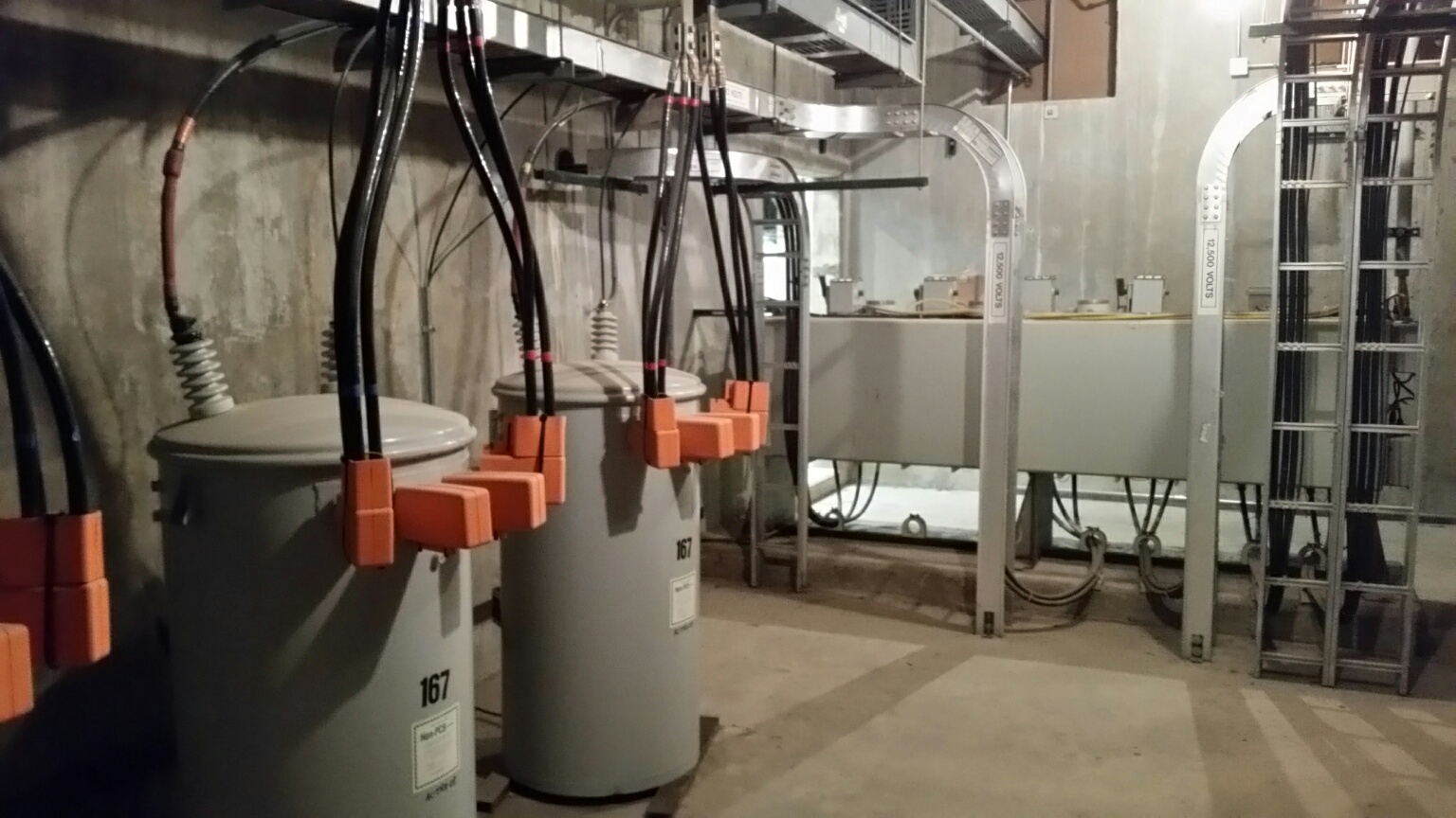

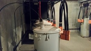

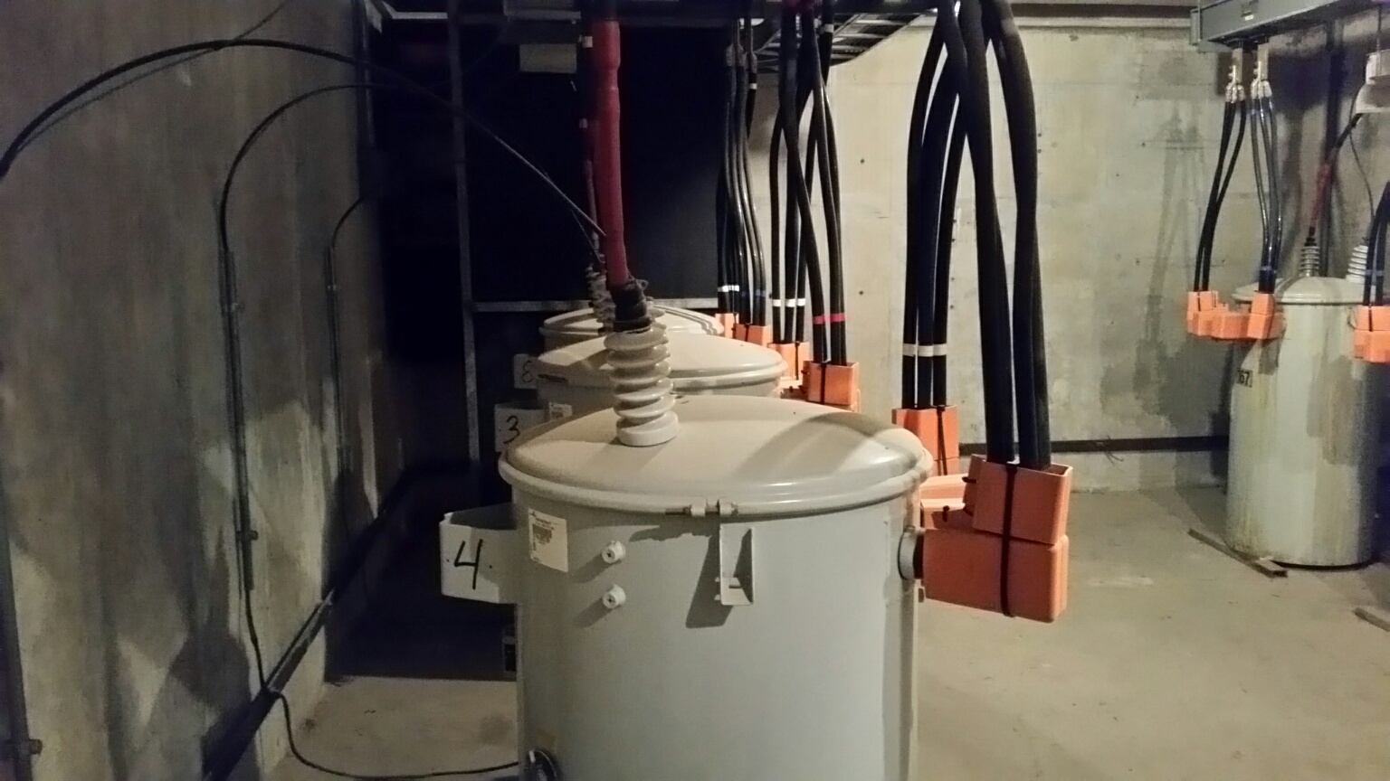

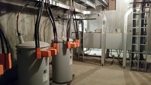

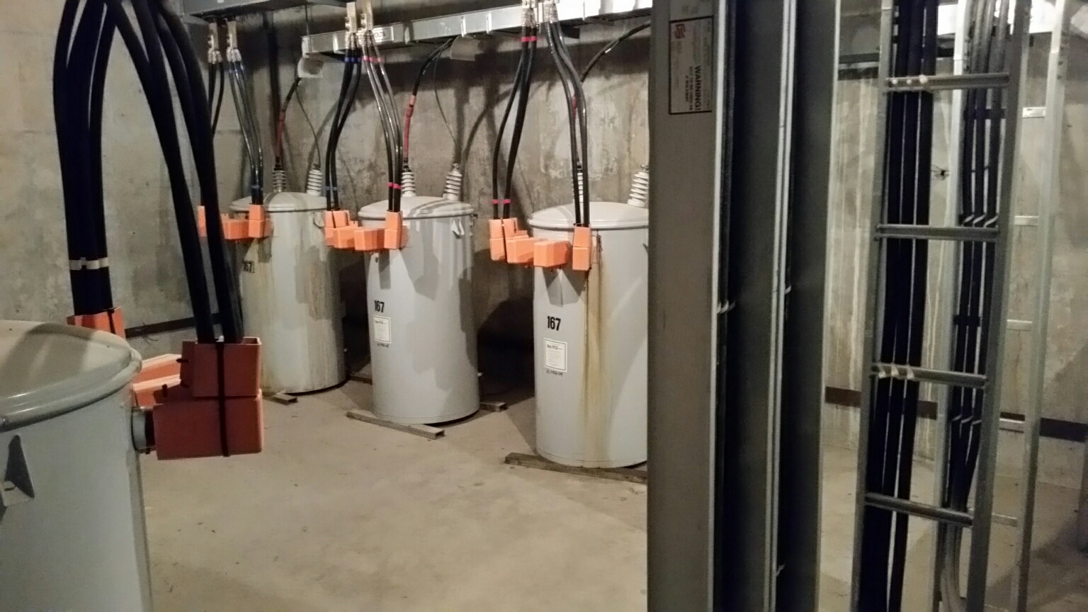

We have a handful of old installations on campus using single phase oil filled cans to make three phase power like you see in the pics below. We put the orange rubber boots over the paddles several years ago. In recent years we've determined in most cases we cannot open the doors on our pad mounted transformers while energized due to too high of incident energy. We discussed installing rubber boots on the paddles like you see in the pics below on our pad mounts too.
In your opinion, would doing this eliminate exposure to live parts?
We have over time converted most of our pad mount to external oil sample ports and drains so we can now take samples without opening the doors and we buy new transformers with the external drain but you still cannot see the gauges or see if you have a spare conduit or how feasible it is to add another feeder etc.
Thoughts?

The installation depicted violates the two action rule implicit in the codes. Pad mounted equipment is built so the door must be opened and an elbow be pulled before one is exposed to medium voltage. In a substation, live parts are guarded by height or secondary guards once one gets past the fence. Here it appears there is only a single door keeping unauthorized folks away from the exposed primary bushings.

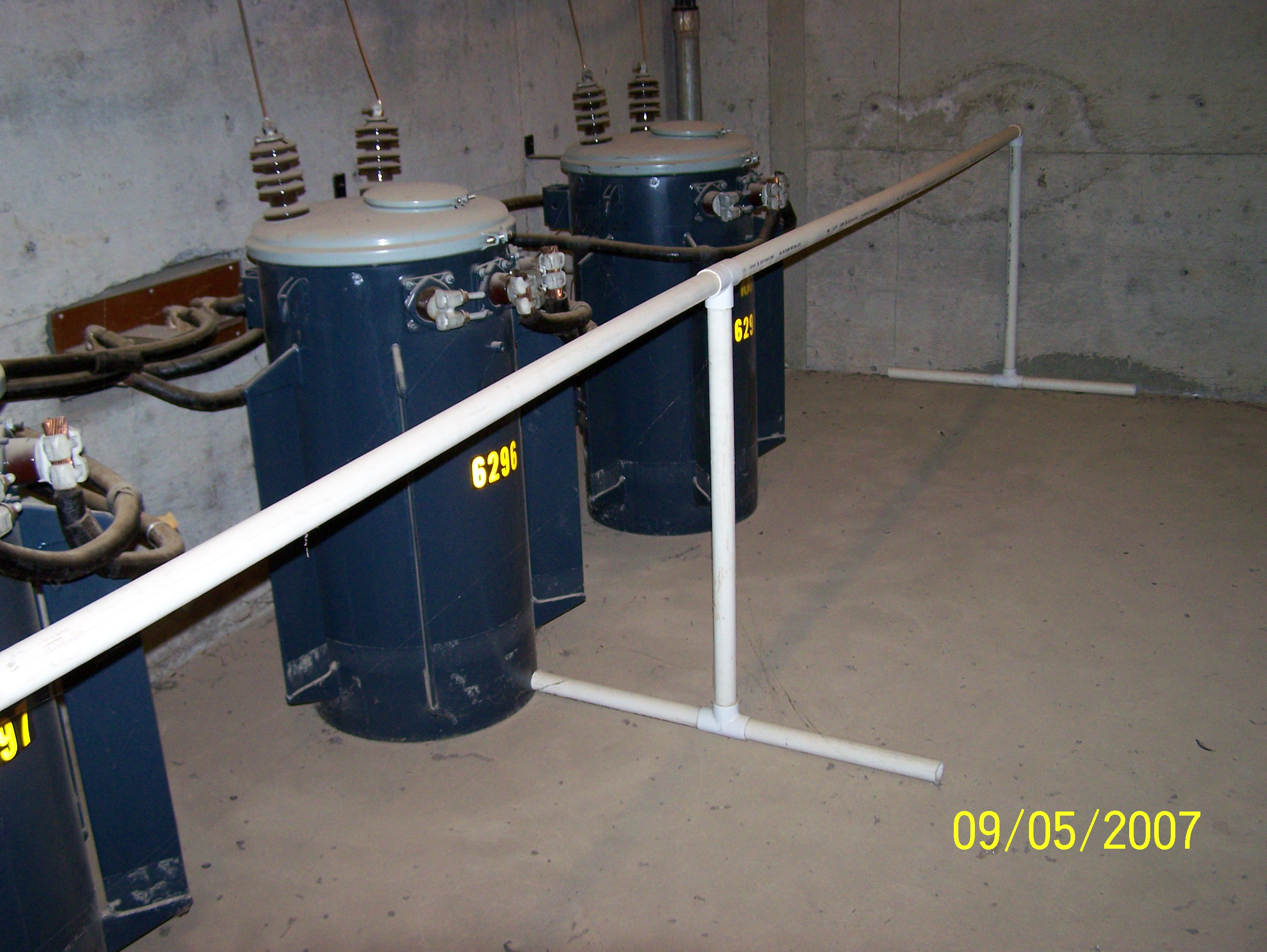

Here's a photo of an inadequate, easily moved secondary guard. I understand the janitor was given a key so he could mop up after the rain blew in through the door vent. All gone now.

The rubber boots will help protect against inadvertent shock and could prevent an arc flash event.
The item I don't understand is your statement
How was the determination made? What voltage are the secondaries of the padmount transformers? NESC Table 410-1 lists padmount transformers as 4 cal/cm2 up to 600V and 601V to 1000V as 6 cal/cm2. IMO that is not too high of incident energy as PPE is readily available and utilities open many padmount secondary doors with no incidents.
I do like that you are ordering the transformers with sampling ports that are accessible from the outside.

My pics are to show the boots, not the pad mounts install I'm asking about. Oh, and in the pics the primary bushings are insulated. You can open the door to the secondary side of a pad mount without opening the primary side door. Have no idea what you are talking about.

I'll have to look into the NESC section you cite. Arc flash analysis yields much higher than 4 cals on the secondary usually. I have witnessed a secondary L-G fault on a pad mount secondary with my own two eyes that did not clear the primary protection. It did not clear until we reopened the primary feeder switch.
Oh, and we have 480Y/277, 208Y/120 and 240V delta pad mounts. All primaries are 12,470V delta.
Where we still have single phase cans they are in vaults behind 2 locked doors. The first door is into a mechanical or electrical room accessible only to our maintenance staff. The second door, the vault door, is keyed only accessible by our high (medium, really) voltage electricians and me.

IEEE 1584 is valid when you have a much smaller enclosure than your typical padmount with three vertically oriented bus bars in close proximity, around 25 mm for 480 V systems for instance. There is nothing whatsoever about a padmount transformer represented by that data.
NESC relied on testing actual equipment for doing their testing. It shows MUCH lower incident energy compared to IEEE 1584 calculations. The tests were for the most part performed by and published by EPRI. Any EPRI report over 10 years old (and some even more recent) is available for download for free. EPRI compared the actual test results to IEEE 1584 and quickly came to the conclusion that actual testing is necessary for accurate results for this type of equipment. They did several tests representing various extremes and took the worst case values which are used in the NESC tables.
So given a choice between actual testing and a computer generated number that is clearly not representative of the actual equipment, which one would you trust?

.. Oh, and in the pics the primary bushings are insulated.
Agreed, they are insulated by air, easily bridged through contact. There is a voltage gradient along the bushing surface, from ground potential at the bottom to line potential at the top. This surface is and must be considered live.
Two actions. Good. Thought I was seeing daylight coming through the door in the last photo.

Not always implicit I guess. In the case of pad-mounted equipment, NESC 381G2 is quite explicit regarding the two actions. Been in the code since '73.

Ahh, you got me there. That's cool, learned something new. So now being an engineer I have to explore all the nuances and ins and outs of something new.
Let's review first the structural context of that rule since it seems to more or less come out of nowhere. NESC is organized into 5 parts. Part "0" (it doesn't have a label) applies generally. If the "2 action" rule was intended to be universally applied it would be in this section like the Rule 09x section for grounding. Part 1 which contains rule 110 and 124 is for generating stations. The "2 action" rule appears to be supported by but is not implicit in these rules. In fact they are more like a variation on how NEC is structured. I'll cover that later. Part 2 is for overhead supply and communication lines. No "2 action" rule. Might be able to make a case for "very remote" overhead access but this is certainly not the intent. It only becomes "very remote" because the lines are not fixed and we have to tag into account sag under all conditions as opposed to wiring that is supported continuously as in general construction or underground wiring so the distances of necessity must be much larger. Part 3 is for underground supply and communication lines. Rule 381G is in THIS section only. Part 4 covers operating rules for all supply and communication lines so no equipment design rules are in this section.
The pertinent part of Rule 381G is:
"Access to exposed live parts in excess of 600 V shall require two separate conscious acts. The
first shall be the opening of a door or barrier that is locked or otherwise secured against unauthorized entry as required by Rule 381G1. The second act shall be either the opening of a door or the removal of a barrier."
That pretty much states and clarifies the "2 action" rule.
So fence or door to the room, then another door over the enclosure itself. I think I see now how the padmount distribution transformers meet this requirement without a building or fence. The high voltage side has a separate door that is covered by the outer low voltage door so you have to open the low voltage side to access the high voltage side. Signage is often an afterthought. I'd say 90% of the ones I see that Duke and Dominion own don't have any kind of "danger" signs. Maybe they did at one time but not over the years. The doors themselves meet the internal barrier requirement. Simple and efficient without excess parts.
Going over to the utilization side (NEC), the rules are similar but there are also major differences:
"110.31 Electrical installations in a vault, room, or closet or in an area surrounded by a wall, screen, or fence, access to which is controlled by a lock(s) or other approved means, shall be considered to be accessible to qualified persons only. The type of enclosure used in a given case shall be designed and constructed according to the nature and degree of the hazard(s) associated with the installation.For installations other than equipment as described in 110.31(D), a wall, screen, or fence shall be used to enclose an outdoor electrical installation to deter access by persons who are not qualified."
Note the wording here. Except for the last sentence which applies only to some but not all outdoor equipment yards, a lock is NOT required. The whole purpose of this rule is to support live front construction...bare bus bars and open insulators without any enclosures at all where the locked doors and gates are quite literally the "enclosure" protecting unqualified personnel from exposure to energized work. We need to prevent access to exposed equipment elsewhere in NEC and other Codes so this rule confers that special status. This rule does not require a locked door/fence, only conveys the "qualified personnel" status. Furthermore, this is not a "2 action" rule by any stretch since the equipment can be energized, live, and exposed for all the (qualified) world to see.
110.31(B) explains indoor locations accessible to unqualified persons and simply requires "Indoor electrical installations that are accessible to unqualified persons shall be made with metal-enclosed equipment. Metal-enclosed switchgear, unit substations, transformers, pull boxes, connection boxes, and other similar associated equipment shall be marked with appropriate caution signs."
Note that the sign goes on the equipment, not the fence/building doors. With metal enclosed equipment frequently there are two doors on the front. Draw out switchgear obviously meets the "3 action" rule with an outer door, the draw out mechanism, and the shutters to get access to live bus. But go around to the back side and remove the cable entry access door and it becomes only a "1 action" rule. Metal enclosed equipment is sometimes "2 action", sometimes "1 action".
I also checked the ANSI Codes for metal enclosed and metal clad equipment. There is definitely not a "2 action" rule anywhere implicitly or explicitly in those Codes. It definitely implicitly exists as a "3 action" rule for metal clad draw out switchgear but not for anything else and even then it only applies to the front, not the back.
Outdoor installations fall under 110.31(C) which states, "Outdoor electrical installations that have exposed live parts shall be accessible to qualified persons only in accordance with the first paragraph of this section and shall comply with 110.34, 110.36, and 490.24." Unlike NESC there is no elevation or fencing requirement. You can put a barrel style pole mount transformer with open bushings on the ground and have open bus bars or cables right up to it, surrounded by an outer fence. Not that in this day and time I really recommend that construction technique, and I hate working on them, but they meet Code.
Finally, 110.31(D) covers what would be the most equivalent to the situations described in NESC 110 and 124. It is for outdoor equipment accessible to unqualified pesonnel including John Q. Public: "Ventilating or similar openings in equipment shall be designed such that foreign objects inserted through these openings are deflected from energized parts. Where exposed to physical damage from vehicular traffic, suitable guards shall be provided. Nonmetallic or metal-enclosed equipment located outdoors and accessible to the general
public shall be designed such that exposed nuts or bolts cannot be readily removed, permitting access to live parts. Where nonmetallic or metal-enclosed equipment is accessible to the general public and the bottom of the enclosure is less than 2.5 m (8 ft) above the floor or grade level, the enclosure door or hinged cover shall be kept locked. Doors and covers of enclosures used solely as pull boxes, splice boxes, or junction boxes shall be locked, bolted, or screwed on. Underground box covers that weigh over 45.4 kg (100 lb) shall be considered as meeting this requirement."
This rule is clearly intended as a "1 action" rule but goes above and beyond NESC fence/door requirements as far as limiting access to John Q. Public.
So in summary the "2 action" rule applies to underground and thus vault entry padmount equipment under NESC (voluntary). It doesn't apply to other conditions within the NESC nor to NEC installations, and isn't a regulatory requirement either. But it certainly explains the door arrangement on padmounts. It never really made sense to me because sometimes I need to do something on the primary side which I can do without energized work when it uses elbow connectors (no exposed wiring) but I'm stuck having to do energized work because I have to open the secondary side which often just has NEMA 4 hole pads just so that I can access the primary side.
